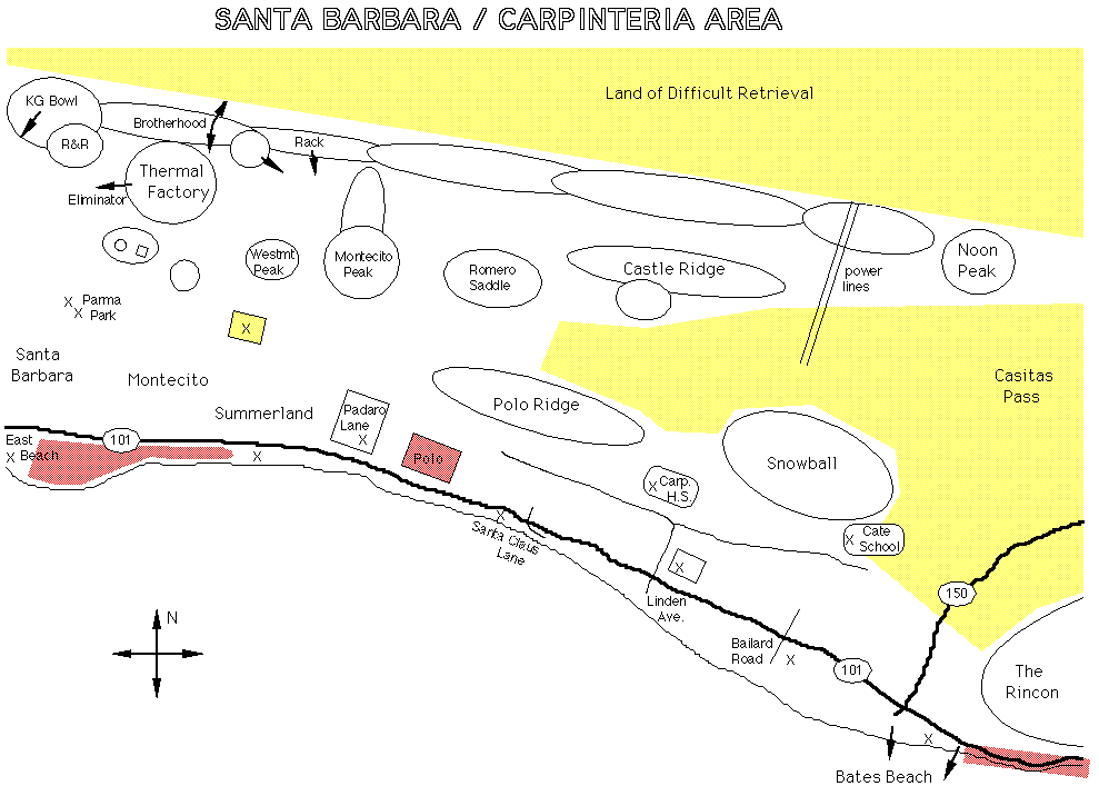

Carpinteria, CA
Coastal Ridge with XC potential

This site is soarable in westerly pre/post-frontal conditions - often the same as are good in Santa Barbara. Frequently Bates will appear too calm on arrival but will suddenly improve. Because of the local topography the wind conditions may change abruptly in the region of Bates, so look for wind lines on the ocean moving in toward shore indicating such a boundary is about to pass. It is frequently possible to transition from the Bates ridge to the main Rincon Ridge in back and head XC east southest toward Ventura. The first 1.5 miles of this flight are DEVOID OF LZs (i.e the side of a cliff, the freeway or the surf). Unless you are experienced at this site you should not try to make this jump with less than 700 - 800 feet altitude. Once beyond this first section there are a variety of small LZs near the freeway.
Directions
