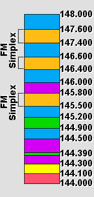

The 2 meter amateur radio band is allocated by the FCC for the exclusive use of licensed amateur radio operators nationwide. It starts at 144.0 Mhz and ends at 148.0 MHz. The band is divided into sub bands allocated for specific uses and specific types of transmissions. Figure 1 shows a graphical representation of the sub bands (Courtesy of Utah VHF Society). Some of these allocations are mandated by FCC rules and the rest have been agreed upon by national and regional amateur radio associations.
.GIF with 2m bandplan shown here
2 Meter Bandplan

Of particular importance to us are the sub bands allocated to FM Simplex transmissions. This is the term used to describe direct station-to-station FM transmissions that do not go through a repeater. This is what is most commonly used in our paragliding activities.
Most pilots are unaware of the other modes of transmissions that go on in this band, for example FM repeaters (more on that later), packet radio, amateur satellite uplinks and downlinks, single side band voice  (a mode used mainly for long distance communication with weak signals), automatic position reporting, and CW (Morse code). Of all these modes, the only ones you can hear on a typical 2 meter FM handheld radio are FM repeaters and packet radio. In other words, if you are transmitting over and interfering with other types of transmissions you will not even know that you are doing it.  This is why sub-bands and specific allocations exist.
A quick glance at figure 1 shows that 144.15 and 144.25 MHz are in an area dedicated for single side band voice only and specifically exclude FM simplex.
Three sub-bands are allocated for FM Simplex. The total width of those sub-bands is 0.68 MHz which is enough for 32 individual frequencies. In other words, we basically have 32 choices for what frequency we would like to use as our XC frequency.
There are a few frequencies within those FM simplex ranges that have specific uses. For example, 146.52 is the national calling frequency. This is where operators trying to make contact with other stations broadcast their call sign and location. This would obviously not be a good frequency to use if you are trying to avoid chatter. Another one is 145.55 which is used occasionally by operators to make contact with the Mir space station and space shuttle missions. I would like input from the local radio community as to other "busy" frequencies which are best avoided. However, these will be few and we will still have many choices. The ideal range is probably 147.40 - 147.60 MHz in 0.02 MHz increments (e.g.147.42, .44, .46, .48, ..etc). A number like 147.50 would be easy to remember.
